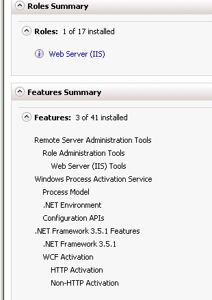

Thanks, Joe. I'll dig into this with GoDaddy. The server is fairly "basic", i.e. 1 role: Web Server (IIS) and 3 Features installed. I don't have any SMTP server settings enabled. I've included a snap shot of the settings.
Would you be able to point me to a KB article, etc? I'll let you know what I hear from GoDaddy.
